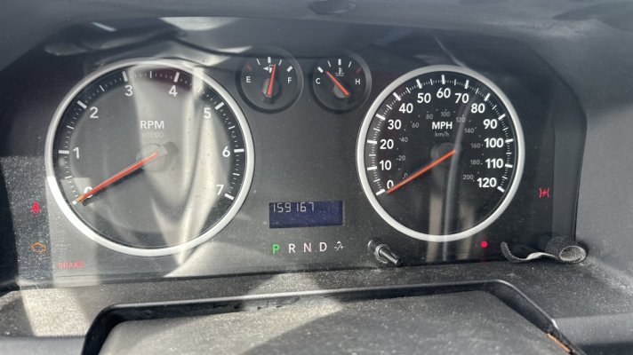

I had to replace the alternator, it died while driving and had to get it towed. Last Friday I replaced it and it started right up and ran. I turned it off and charged the battery over the course of Saturday. Monday morning go to start it to go to work and I get all the normal lights and no start. Not even clicking. red security light and the ]lightning[ are on. I check the fuses I can see have to do with ignition and find nothing blown. I have a neighbor with a scan tool and I pull the codes.

v6 3.7
Is there any way to test the winmod or the PCM to know where the issues lie? I have tried every reset I could find. I removed the battery cables for over 12 hours. I have removed just the negative for several hours. I put the key in the ignition and left it there, got in locked the doors then unlocked the driver's door by hand and turned it on and off three times, all with no change. I don't have a fob, never did only the key I got when I bought it. I would just like to know more about where the problem lies so that I can move forward and fix my truck. I have attached the images of the codes and the dash. The lower right red light blinks.
