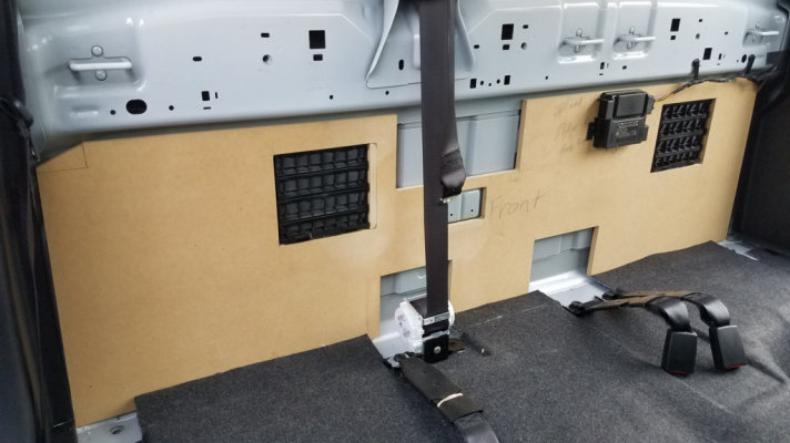

Check the red wire that goes between the ignition & module behind the small rear seat
