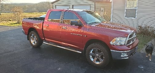

All I wanted was to level my Ram. The tire and muffler shop didn't use Bilstein, so they told me to get what I wanted and they'd install. Today, I arrived with my Bilstein 5100s and a new set of Moog mounts. Which is all I thought I needed. I bought the mounts just in case the current ones might have a lot of rust (they didn't).
They discovered to my surprise that my Ram had spacers! Not even 2" spacers. The truck had a noticeable rake. So I initially told them to leave out the spacers. The mechanic comes back to me and says he believes even with the shocks set to their highest that the truck will set lower without the spacers, so now they're installing the spacers along with the 5100s set to 2".
So far, I've been here about three and a half hours. I'm worried that I'm going to end up driving home needing to raise the rear.
Did I pick the wrong shop? Is it something to do with 2011? 4a559a783fb4b9f16f02c098f7642627.jpg

If thats a top-mounted spacer, you probably have some daystar 1.5” spacers or similar. Thats what I put on my ‘06 and it has just a LITTLE rake. Spacers get a bad rep because a few people have rough rides, but if you’ve had spacers all this time and didn’t realize it i doubt you’re having the ride quality issues lol
If these are top mounted spacers, to get rid of em they would need the stock coil spring isolators to put back in their place, and his excuse for using the spacers is probably just another way of saying it’d be much easier to use the spacer than it would to track down stock isolators to put in its place. I’d just wait it out and see, if the truck sits too high in the front just lower the bilsteins until your truck is sitting level and call it a day. As long as your ride quality is good and your truck sits level in the end I think you’re in the clear lol

I appreciate your reply and insight. I'm betting you're spot on about the coil spring isolators.
Been over 4 hours now...

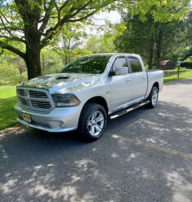

I've installed bilstein's on many rams even on my own you dont need spacers and over 4 hours to install thats way to long maybe you picked the wrong shop. Hopefully they do a good job how much are they charging you ?

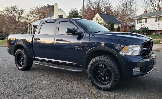

Sorry man. Sounds like you got taken. I have the Bils on mine set to 2.8. Been riding that way for over a year and a half now without issue. The instructions for the bils was very straight forward along with videos of guys actually doing the bils. About the only thing I did differently was new MOPAR coil springs up front and upgraded the rears to TUFTRUCK TC-1211 springs. My other suspension upgrades were JBA UCAs up front with SuspensionMAXX sway bar links and all Core 4x4 on the rear. Both sway bars are still my originals. I had a FUN time doing it in my garage. I've put over 50k miles on it since then. I'm about to turn 243k on the clock and still running the original shafts, boots, and joints.
