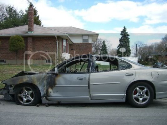

Or GM with Grand Prix's catching on fire. Ask me how I know..lol
