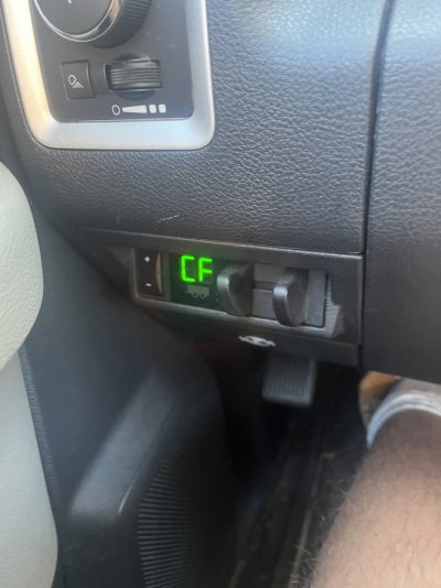

IMG_2372.jpegOn my way to work this morning. The service 4wd light and traction control light came on. Also the trailer brake light and the controller was flashing CF. No check engine light or ABS light. I replaced the brake switch since I was reading that could be one of the culprits. Still does it even with new switch in place. I thought possibly a wheel speed sensor but with no ABS light I’m kind of thinking perhaps not.IMG_2371.jpeg

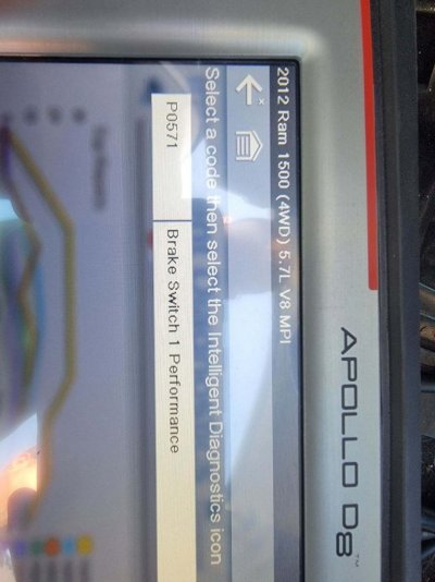

These are the codes I’m getting

Looks like you have a scantool that can talk to more than just the pcm, can you actually communicate with the ABS module?
The set criteria for the P0571 is:
Set Conditions:
  • The output signal of Stop/Brake Lamp Switch to the PCM looks like it is not applied, while Stop/Brake Lamp Switch Output circuit is applied.
It also mentions "incorrectly adjusted brake switch" as a possible cause.
The U0401 is a communication code:
  • Set Condition:
    When the Drivetrain Control Module (DTCM) detects an incorrect Controller Area Network (CAN) message from the Powertrain Control Module (PCM) after receiving at least 1 correct message from the PCM.
The C1000 I couldnt find anything on...
It could potentially be a communication situation but you would need to scan all modules to see if theres any more comm codes...
