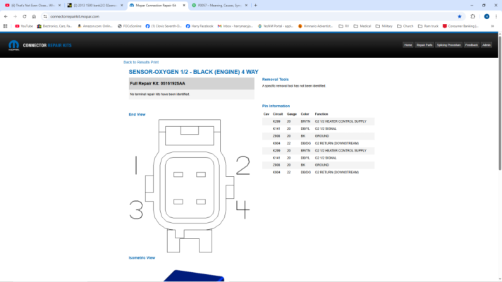

live data. you can look at the OBD2 live stream and see if it is responding. Heater control circuit low means either a blown fuse or a broken wire or bad ground. You will have to access the connection for the sensor and check the heater wire and heater ground. You should have 5VDC or so on the heater wire to ground.

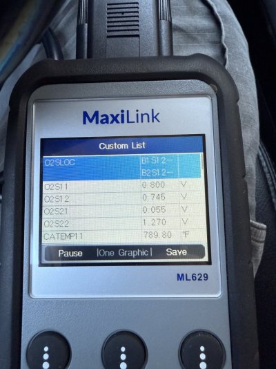

Thank you for the quick response. Sorry I’ve been working a lot of overtime or would’ve gotten to the sooner. I was able to look up the live data and this is what I’m showing, but to be honest, I have no idea what the values should be and with this means as far as if it would be a bad ground or a clipped heat of wire, etc.
