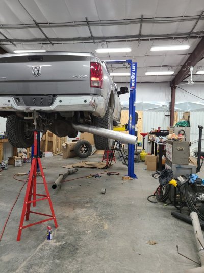

Doing the HVAC box rem and install. The interior removals are coming along no probs. The underhood work has got me thinking about putting it back together and taking it to the shop...I can't figure how to access the spring clamps on the heat core against the firewall. I pulled wheel and inner fenderwell off. Can't do it. From YT..guy says you can pull the HVAC box into the cab and disconnect them in the cab. Which sounds doable. Prob is I also can't access the quick connect fitting on the heat hose supply. The white tabs are too close to the valve cover. WTF. I do work on vehicles as a hobby like most of you. Am at my wits end. Any tools you wold recommend? I am all about buying more tools. Any suggestions would be greatly appreciated. Thanks. See pic of 5in pipe I put on 3days ago.
