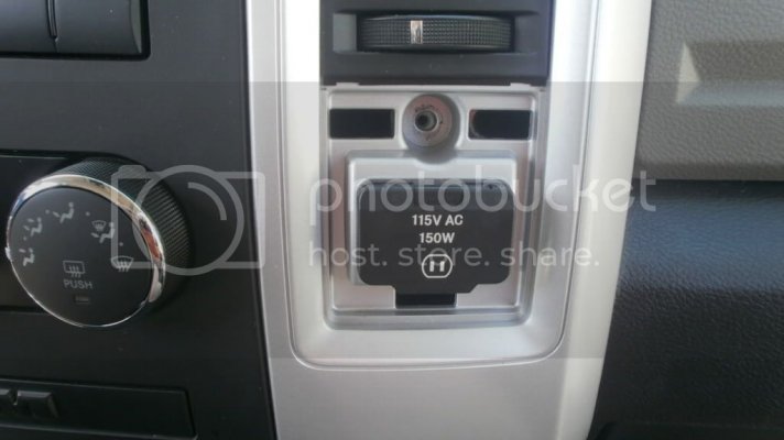

Ramzaq
Oct 27, 2013
443
114
Northern California
2009 CC 4X4 3.55 Big Horn
If you have the AC outlet in your dash there is a screw right there also.
Obviously mines been taken out.
