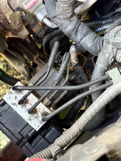

Fired up my truck last night when a mile to a store went to leave noticed my brakes were getting spongy figured it was cuz it's been sitting a week or so. Got home and started pumping them a bit noticed my truck smoking opened the hood and it's saying from what looks like a aluminum wrapped like but when I traced it back it looks like its going to a wire cluster. Any ideas? I'll try to take pics tonight and if there is any fluid left I'll see if I can get a video of it spraying. My dodge beem nothing but issues since I got it.

I have attached some photos I'll try to get a video of it spraying I just wanna add more fluid before I do that I don't wanna run it dry. But anyway I circled where it appeared to be spraying from. It doesn't make sense cuz that bundle appear to be a wiring Harness.

Degrease the area where it’s wet from fluid . Unwrap the insulation and tape and see what’s going on .
