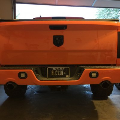

Yup did the same thing, drilled and jigsaw then cleaned it up with a grinder
