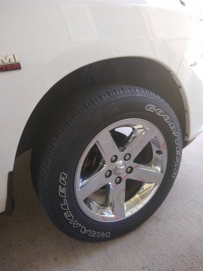

20" wheels are the factory standard for the Express. Post a pic, or just compare to the ones in my avatar, to see if they are the OEM ones.

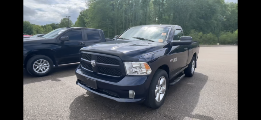

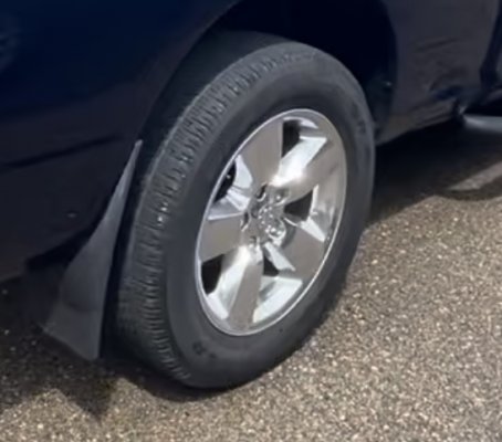

Not looking to replace the wheels just get a compatible spare just in case of a flat. Attached pictures.F6D8CA85-34E9-4B2A-AF1E-125017CFDDAC.pngA88C50CE-986D-4E42-B0A6-96E8363E6D4B.jpeg

I think the OEM spare is a 17" steel wheel. A full size wheel should fit in the spare location with an OE size tire. Make sure the lift mechanism works. Though if the truck is from 'bama, you shouldn't have much rust lol.

Don't get the same 20" wheel for your spare. The anchor may be too big to pass through. I found out on my '08. Pretty sure 3rd gen wheels are interchangeable as well.

Not looking to replace the wheels just get a compatible spare just in case of a flat. Attached pictures.View attachment 492155View attachment 492156
That's a nice looking truck.

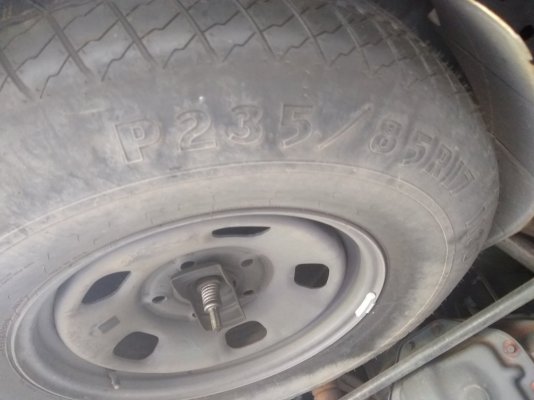

FWIW, I still have my original spare and it is a P235/85/R17 mounted on a steel wheel.
My 2017 Express came with the chrome clad 20"×9" and if I should have a mishap with one of them they are expensive to replace, especially an oem/original.

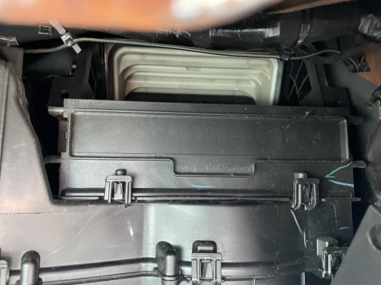

I decided to not get the truck. Asked to see service done on it and the copy indicated cabin filter replaced. Picture from my inspection.

Correct me if I’m wrong but shouldn’t there be an access cover?
Yes, there should be IF it has the factory cabin filter.
It is possible that a cabin filter retrofit was installed post-factory, which requires cutting a hole in the firewall from the engine bay side.

Cutting hole in firewall? My truck looked exactly the same as this I cut out the spot and added a filter. Not sure what this firewall speak is.
