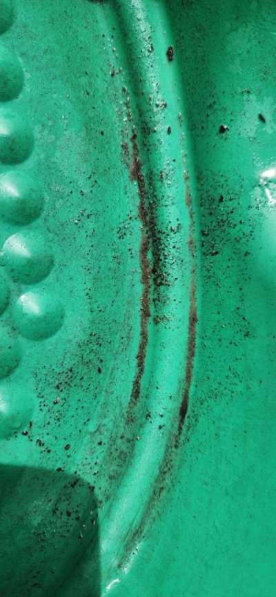

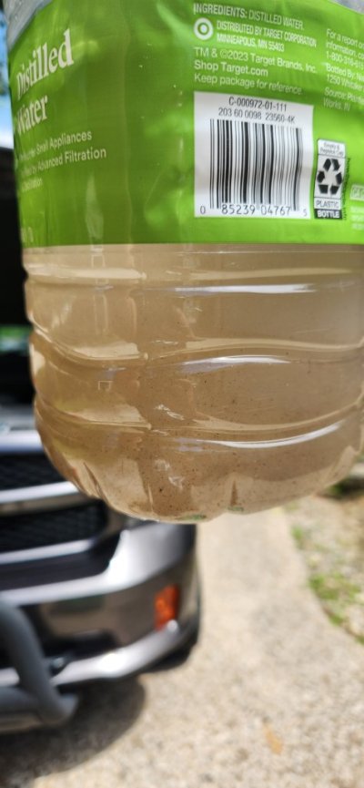

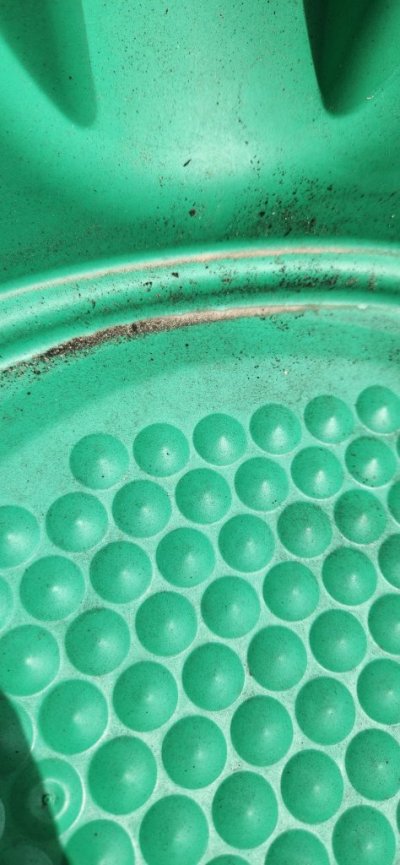

Clogged heater core? If you've never back flushed it I'd do that and change the antifreeze. Mine had a bunch of casting sand in it from the factory. If I'm not mistaken, the top of the heater core supplies passenger side heat and the bottom driver side heat. The bottom is where clogs will accumulate.

This is correct except for the sand part. Sorry but it's not sand. The easy route would be to change the heater core and flush it yearly. This to is ideal for flushing. The fact that your truck is a 13 likely means the material in the core is to compact to flush it out properly.

Definitely sand...it's a known issue.

No, but there is enough remnant from the manufacturing to cloud that container and for some to block the heater core...seems to be a manufacturing oversight in multiple CDJR engines too.

Do they by chance clean any parts with sand? It's definitely sand that came out of my heater core.

I can tell you for a fact that what came out of my heater core was 100% grains of sand. The block and head on the 6.7 Cummins is sand cast. I've seen coolant do some nasty stuff but I've never seen it create actual grains of sand. Sorry, but I don't think anyone is buying it.
