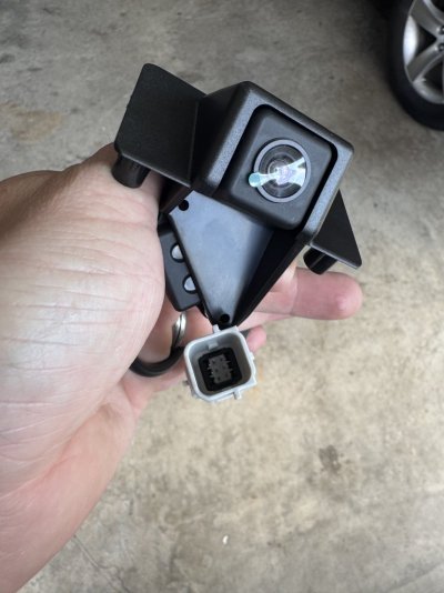

Backup Camera issues are driving me crazy! So here is the deal, I've got a 2013 1500 Sport and the backup camera started glitching out a few months ago. Now it just goes to blue screen.
Here's the problem - the handle appears to be a MOPAR handle but the camera doesn't match any of the original cameras.
Someone installed a Nav-TV system in it and it appears this is how they got a backup camera going, but the connector for the camera is different than any camera I can find (6 pin one in my hand).
On my Factory Build Sheet is says it had the backup cam installed along with the RA4 8.4 inch radio but I'm guessing the camera went out and it got changed to this other style.
Any ideas on what to try/check? There are no markings on the camera at all.

Thank you! I will check the fuse. It’s super weird because this camera size and connector look identical to gm/cadillac.

That does look like what you've got.
(Got a Link to it?)
Someone may have modified the wiring harness inside the tailgate to accept a different camera/connector setup.
You'd need to see what's going on at the bottom i550 tailgate connector by the spare tire up the the camera to see where the OEM wiring changed vs the schematics.
Depending on where the changes happened (ie only inside the tailgate) it may be easy to grab a used 13-18 1500/2500 or 19-24 4th Gen classic 1500 tailgate and camera/lock harness set with a handle and camera from a local salvage yard I get up and going again.

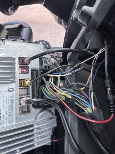

Side question/just noticed....
Are there new/non factory wires spliced in at the back of the radio connector?
If so which pins ?
(31,32,33 are backup camera)

Radio connector Pinout added to prior post above.
OEM camera wiring may likely missing (and/or modified) in multiple spots since there's an RCA pigtail added in to the OEM connector for aftermarket camera feed.
Not sure what pins the other splices are on from the picture ?? or how they grabbed power & ground for the camera??
If any of the splices were done poorly, ie just wrapped around a wire and taped up, that would be a big potential issue. (Vs soldered & heat shrink)
Please identify all non OEM spliced radio pins/signals.
(There are a few that look like they were fully cut and ReRouted to something else?)
** No one should be cutting into these factory radio harnesses when OEM to aftermarket inline adapters can be found easily enough.

Well, tried this guy out but no luck. Same connector and box but no signal. So maybe not the camera, but instead something else. I believe 31/32 are sending power to the camera when tracing the lines but the “Nav-TV” box has to be doing something. Could be it. Idk. I’m pretty sure my oe had the wiring in the harness for camera but for some reason they added all this aftermarket stuff.

Please see the previously attached schematics. If you're not comfortable/familiar with vehicle wiring get someone to help you out. ... Radio pins 31/32 are not power, they are the analog video signal.
... And no one knows what the 6 pins are on that aftermarket/NavTV/gm camera (ie power, ground, Video Signal, video return, Video shield? & 2 other pins?)
