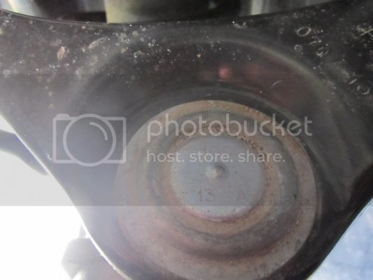

build date 4/13 I have been checking my UCA daily.NO GAP...

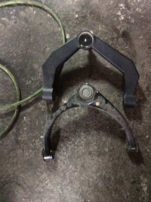

Your wrong tripower. Ball joints are popping with Bilsteins also. Mine did.
Sent from my SM-G900V using Tapatalk
Your signature says you have a 6" lift, which would change things dramatically. Not apples to apples.
Every person I've seen post they have any lift, bilstein or spacers, has popped ball joints to some degree.
Due to it being a safety concern, my safety more importantly then anyone elses, I'll do it right the first time. I plan on running fronts at 2.8 and rear +1 inch if at all possible with addition of zones.
I understand wanting to err on the side of caution, it won't hurt anything but your wallet. That's an easy, safe option if you don't have the time or ambition to fully understand the problem. Most of the people I see recommending UCAs can't really explain the problem. They just know that leveling causes a ball joint problem... and leave out all the 'why' detail. They haven't checked the ball joint angle at full extension with the stock shock and compared it to the Bilstein, but I have, so I know the truth.
A new UCA that's designed to work with a 2.5" spacer lift is complete overkill for a preload lift that, in some cases, doesn't change max extension at all (Rancho). The Bilstein adds ~1/4" total extension over stock, and the spacers are usually 2.5"; way more than the ball joint can take. Totally different requirements.
