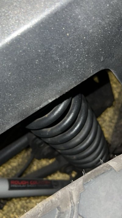

Also, I have these coils in the rear. I noticed the rear is an inch or so higher than the front. Could it be the RC shocks I have in the back or the coils that are causing it?
Thanks in advance for all the great information and details.

The shocks have nothing to do with ride height at the rear. Its the coils. Is there a spacer above or below them?
The front looks like the original struts with a spacer, so very possible the rear springs are stock with a spacer as well.
Looks like you are due for tires…those things are quite weather checked!

Post more pics. How do rc shocks end up on a truck with a BDS kit?
Let’s see the cross members in the front.
Since the angles on your UCA’s look good now and you’re being budget conscious with your decision I would run the mevotec UCA’s they are tried and true. They will be your best bet and leave room in the budget to replace the RC shocks in the rear
