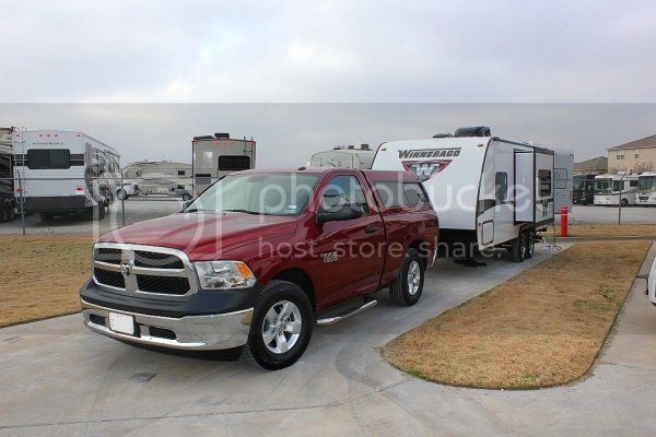

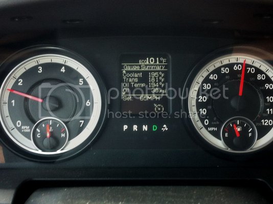

I have about 5800 miles on my 2014 RAM. I have found this thread very interesting. Here is a photo of the EVIC on a very hot day while not towing. The temperature gauge is almost up to half. So far I have towed 2 different trailers a total of 2900 miles and have never noticed any over heating. Next time I tow I'll get some more EVIC photos.
Bigbird, I'm really glad you posted this and the photo. Now I can take a copy of your post to my dealer (when they get back to us) and let them know that there are other Pentastars that behave properly.
Our RAM was located in the State of Washington and was acquired by the dealership where be purchased it (in California) through a "Dealer Swap". So I don't know for sure if it even has all the California Emissions crap on it. California cars and trucks are supposed to run hotter so as to please more "Global Warming" kooks...me thinks :signs6: !
I am glad this might help. If there is anything else I can do then let me know.

Just thought I would post one more photo of a good running V6 on a hot day.
Not towing.

That sounds like quite a test for your engine pulling that trailer. We recently completed a 900 mile round trip pulling our 4500# trailer and the V6/8 speed did a great job. We have a 2000 mile round trip planned for next month. I'll be interested in your block tests. Good luck.
