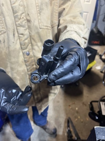

Joe Storts and his smoking stogey let me borrow his smoke machine yesterday and while I’m not knowledgeable on exactly how to plug it in to the engine and smoke it, he included the bottle baby oil to add into it. I’ll try and watch some Utube’s on it and maybe figure that out. If anyone here can detail exactly how to connect it to an 1500 5.7 I would be grateful if you could post on it.
I also mentioned to Sonia as relates to the Vaselining the gas spout rim and she mentioned she’d care for that as she did lubricanting the cap shaft sometime back

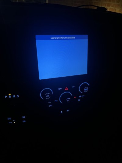

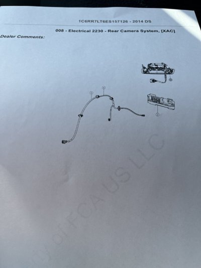

Still trying to figure out what’s doing with that rear cam, haven’t gotten to far on that issue
I did get a lead on a guy that knows how to fix those from his home garage, so at least I may be able to same a few bucks there as the dealership is really expensive. Estimate was 3 hrs labor and parts which were a slightly over a tripod ($327). Still waiting on his contact info

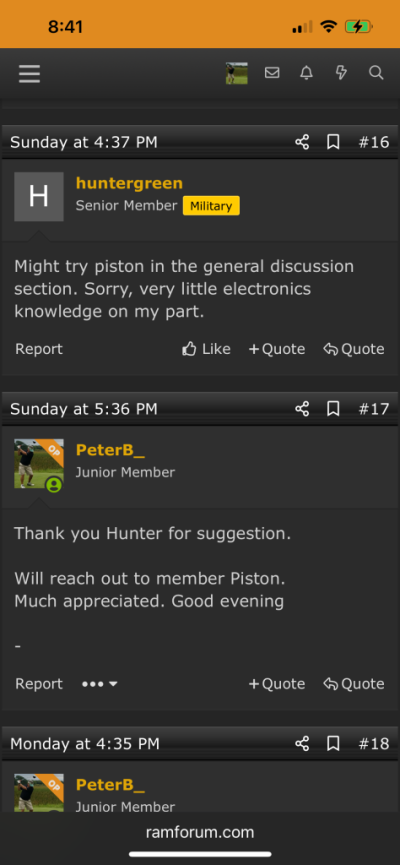

Piston in General was Hunters suggestion …
Anybody know if he’s still around town or is he sleeping with fish ><>

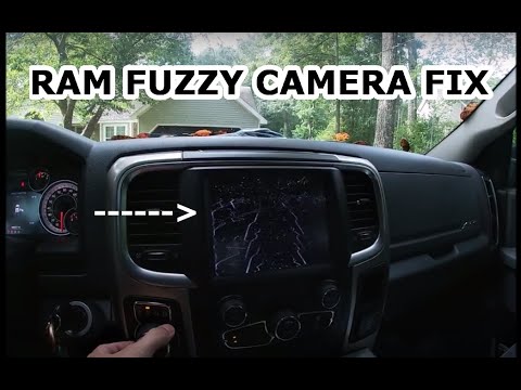

Op you might take a look at this,
Seems the harness and camera are relatively cheap, compared to other ram problems

Yup I’ve seen that one. Problem on my end there no push plugs, switches like he’s referring to on Utube to push together making sure their clipped and tight. I got loose wires and where your statement that it’s cheaper than most other jobs, dealer wants an over $3 hondos by me for parts alone, 3 hrs labor estimated by service writer. Pricey! I was contemplating checking out a junk yard seeing if there’s anything available there, camera clip wise.

Now onto the back up camera repair.

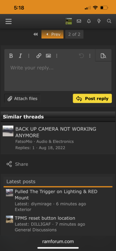

I PM’d him, along with Piston guy, no response from either one ?
Anybody know if FatsoMio is still around these days or did he blow this Forum off too ?
