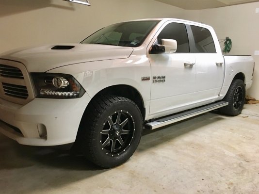

Just finished mine. I am running Fox 2.0. Rides very smooth. Let me know if you have any questions .

yes, spindles, springs and new shocks
Thats a great looking truck! I'm about to install a 4.5 Maxtrac lift kit on my 2wd. What size tires are you running? I'm leaning towards the Ridge Grapplers, how's the ride?

Love the ride...actually as quite as the Nitto Terra Grappler G2's I had before. The kit rides awesome...as good as stock.
Wheels are 20x10, and tires are 35x12.50x20
And thank you for the compliments!
