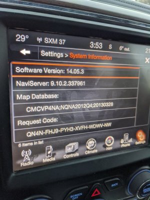

After checking my radio this morning I'm in version 14. 05.x so is it possible to update to a certain version?

I assume you have a Canadian radio/truck?
Yes, if you can find someone that has the Canadian 17.11.x sw for the year and model of radio you have (ie 2014 RA4/VP4-CA?).
I'm fairly sure I don't have any Canadian SW.

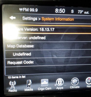

Hi. I have a 2014 3500 Laramie CC. My firmware version is 18.13.17. I am wanting to add chmsl with camera.. i have already used AlfaOBD to turn everything on for cargo camera. What do I need besides the camera. Thank you 20200802_205203.jpg

Responded in other thread.
