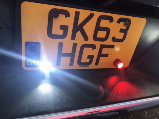

Like I mentioned in my “Introduction” post, I’m in the UK and picked up a ‘14 Big Horn from a coworker before he moved back to the USA. In order for it to be road legal here, some of the lights had to be changed.
My main issue is the fact that my stock reverse light locations are now my rear turn signals with amber bulbs and my reverse light is a little LED on my license plate. This really cuts down on my light output and I’m looking for ways to improve this.
I’m looking at putting some switchback LEDs in my stock reverse light location, this’ll give me bright reverse lights and amber turn signals. I’m looking at the VLEDs Triton system. Has anyone had any experience with this setup or do you know of any other setup that’ll do what I’m looking for?

After speaking to the guy who suggested the Triton System, I found out that I’d have to bore out the light mount. I’m going to hold off on that, at least for now. I’ve decided to try the VLEDs license plate light.
https://www.vleds.com/shop-products/lp-series/lpr-reverse-72-w.html
Hopefully this will help with reversing down my street at night.
