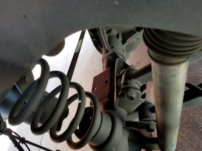

Just spoke with rough country, they said that its put in correct, the N2.2 shocks run that way, the 2.0 run inverted with black rubber up top..

108
Yeah I watched the video also. Here is a pic of my rear spring with truck on the ground. Your springs look like they are binding.

108
From the rear
Springs look like they are binding. Ditto!

What would cause the binding??? i marked everything and seated them right back into the old spots. When u take them out u can can see the marks they leave..
Roger that! Wouldn't think it make a difference though right? As it's gas filled? When those go I'm upgrading to Fox. Lol!
If you put the spring spacer in cocked and it's not seated all the way in the body.

Yeah when installed it lays pretty flat. Real hard to put in crooked. Thank you..
Yeah was a long shot lol. The springs are so easy to install. Not really sure what would cause yours to look like they do...good luck

Replaced all new suspension front and rear ruff country sent 3 new pair of rear shocks cause of rear clunking come to find out their directions are wrong how to put them on.....rubber stopper on top fixed it
