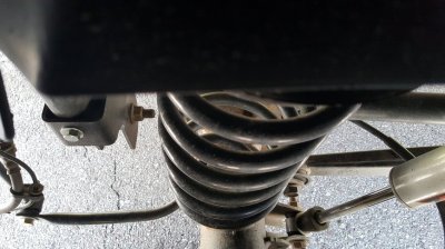

Heres driver side rear spring, looks funky, or no???

Not sure what you meen, panhead bar drop brackets.. only drop brackets in the back are break line and sway bar link end brackets. Rough country 2.0 rear shocks and the 4.5 spacers that mount above the springs. Thats pretty much all on the back.

Your shocks look like they are upside down and my rear spring spacers are on the bottom not the top like your describing but my kit is Maxtrac.

Nah not upside down, lol. Yeah these spacers are designed to be on top with a big washer and long bolt.

Your shocks are the same as I got mine. That's how the instructions said to do it so that's what I did. I might flip it the other way round just to see if it makes a difference.
The 2nd pic confirms you did indeed put 2 holes into the drop bracket for the rear panhard bar, I think that's what it's called? The bar keeping the rear suspension. Aligned and springs from popping out.
