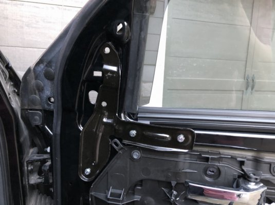

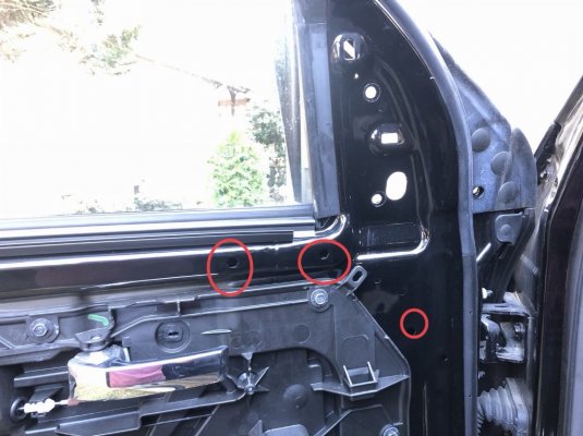

Attaching a few install pics in case anyone stumbles on this thread later! Will put some finished pics up at some point too.
6 T20 screws circled around outside of door. Once unscrewed, pop the female portion out too with a flathead or knife.
One Phillips screw behind the door handle. Will need to use a small flathead or knife to pop out plastic cover behind handle before getting to screw.
Location of 3 Rivnut holes on each side. Passenger side is mirrored. If you need help with these, google Rivnut Ram install and you should find another site that has a great way to install them using an M6 screw and a M7 nut.
Rivnuts installed
Driver bracket installed
Passenger bracket installed

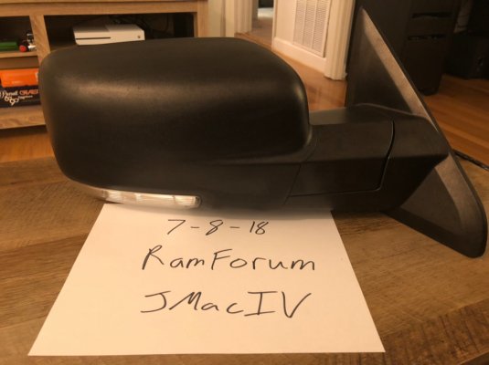

Hate to be that guy.... but I don’t have 50 forum posts to post in the For Sale Section and I was already active in this thread.... if this is horribly inappropriate, mods please delete.
So if anyone wants the non-broken Passenger side mirror, it’s yours for $100 shipped. I’ll even throw in the broken driver one if you want it for some reason.
Came off 2014 LoneStar. Good condition, no cracks whatsoever.
Power fold, non tow, turn signal and heated!
Part number: (P)68231240AB
