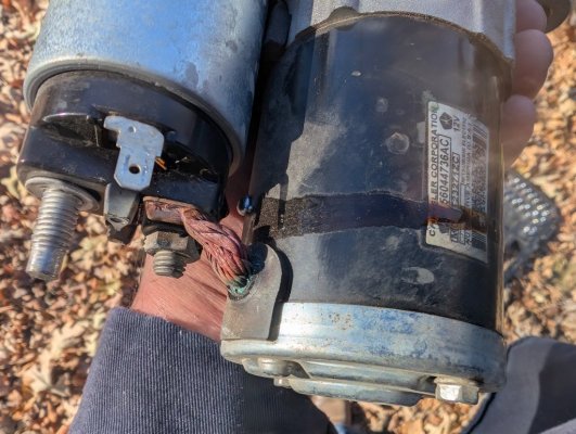

New to the forum. New to auto mechanics. I bought this truck about 4 years ago. It has a little over 250K miles on it. No major issues until now. I was driving home from work and stopped at a redlight. Heat gauge shot to max. Truck died. Towed it home, and it would not even try to start. I had replaced the starter about 6 months before this happened. I replaced the battery after this happened because it would not turn over. The starter solenoid clicks, but that is it. All the lights on the dash stay on but the only thing that happens is the click of the solenoid. PLEASE HELP!!!
Update: I had one mechanic friend say that there is a shutdown relay on these vehicles. Does anyone know about this and where it would be located, or how to reset it?

Thank you all. I did find the problem. The starter fried. I have already replace the water pump, so the thermostat will be next after the starter.1000000313.jpg

Yeah that is what I thought, normally a very easy diagnose, but when two things happen at the same time always confuses the situation. Now you have to keep an eye out for electrical gremlins, because unless you put 100k miles on it in 6 mos the starter shouldn't be going out so soon. Maybe a grounding issue.
So this I must admit is far reaching, but if these two items are related as in grounding issue and electrolysis in cooling system leading to over heating, evidence would be in coolant. RMI 25 both protects radiators from electrolysis and deposits any gunk or rust from system into over flow tank for extraction. It should be called radiator shops secret but this is still an unknown product out there, but I have used it several times and it does what it says, look into it usually available on eBay or Amazon. You can also test for electrolysis in the cooling system with volt meter, Google it.
For now sounds like winner winner chicken dinner, but if something in this ilk happens again soon you could have some stray current, bad ground or short circuit somewhere.
