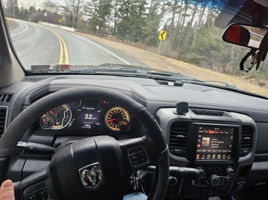

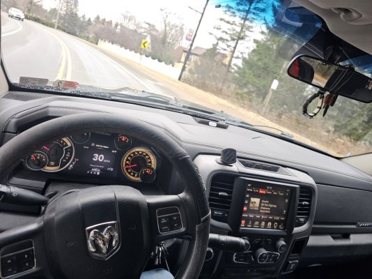

So i decided to swap a 2015 laramie 1500 dash into my 2014 ram 1500 express. It went ok except i didnt realize the laramie was a knobe shift and mine was a column shift. I was able to get around that with unpinning the pins and rewiring them into the harness. My problem now is that i cant get a oem brake controler to work with the harness. They changed the harness in 2015, so i tried to use a 2015 tow module with no luck. Yes its already all programed with a alfa obd2. I am thinking it wont communicate with my 2014 body control module. Any thought? I have been trying to find a 2014 ram 1500 dash wiring harness with column shift, dual climate control and the 8.4 screen with no luck.
