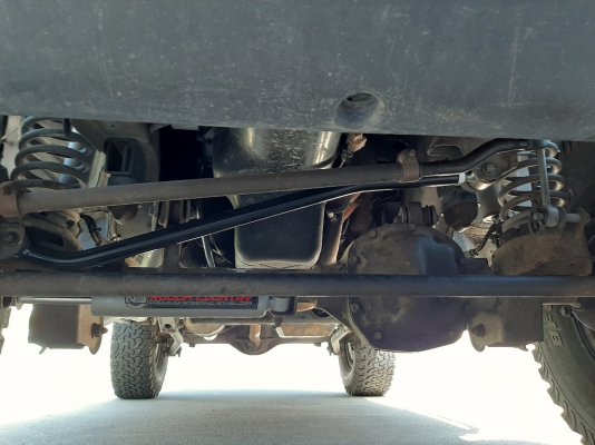

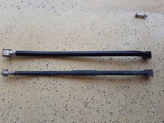

Decided to give a little love to the WJ. ordered an Iron Rock front trackbar to replace what i think it was an RC Trackbar. Iron Rock is thicker and a lot more heavy duty. Also ordered an HD rear sway bar from Iron Rock as well but that one was in back order so i should have it in couple of weeks. The factory rear sway war on this Jeep is super thin so no bueno after a 4" lift so i need to fix that.
Front live axels are just awesome, after replacing the trackbar i just needed to make a slight adjustment on the drag link and she's driving straight again.

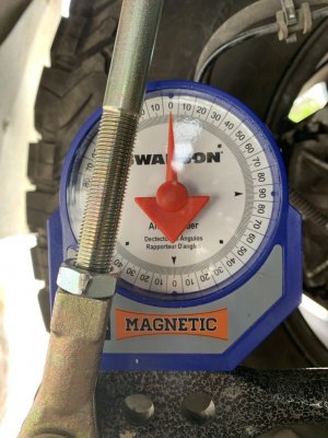

Got the new adjustables JK sway bar links, but the bolt that goes on the frame side is a tiny bit bigger so it wouldn't fit clean. Not a big deal i just need to run a drill bit and literally just clean the holes, the other end fits perfect in the Hellwig bar holes. I had them set at 12.5" eye to eye here.
49914038833_043b98cc6e_k.jpg2020-05-19_06-22-51 by RAM RSM, on Flickr
I didn't do it cause right now the angle on the bar is 5* so anywhere between 3* and 5* should be peachy.
49914550716_28d5009a20_k.jpg2020-05-19_06-22-42 by RAM RSM, on Flickr
My Teraflex links are 12 1/4 long eye to eye so after putting the angle finder they seem fit for 1.5-2" rear lift. I may use the new ones later on or just port them to my Jeep. I'll have them on standby for now until i have the 29" extended Fox 2.5's installed and see if i'll need longer rear sway bar links or not.

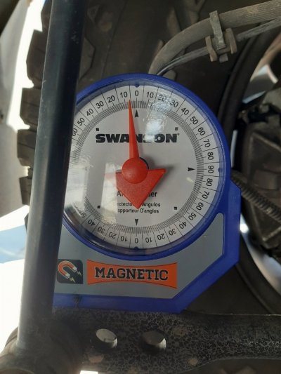

Taking out the comment i posted above about 12 1/4" sway bar links being enough for 2" lift. I kept thinking to myself why the gauge reads 6* yet my eyes are telling me i don't have enough length in the links. Duh, my Driveway is at a incline lol
Sway bar links are JKS 2943, I bought from Northridge as Claytons, and Clayton sent me these ones. Oh well, same price and JKS is also good chit.
So with the truck leveled, this is how my sway bar angle looked like
49927189748_31b6be64a2_k.jpgUntitled by RAM RSM, on Flickr
And the gauge read 15*
49927711636_0249371825_k.jpgUntitled by RAM RSM, on Flickr

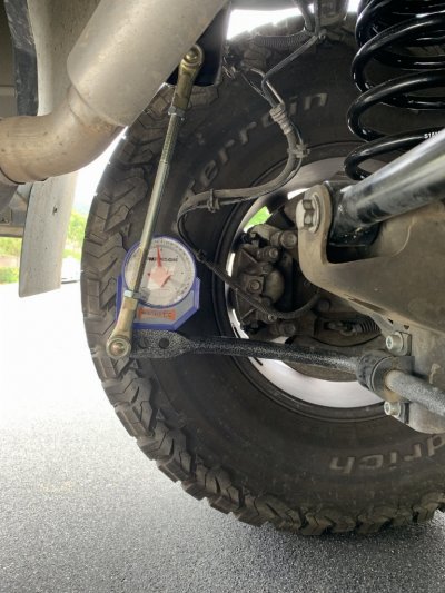

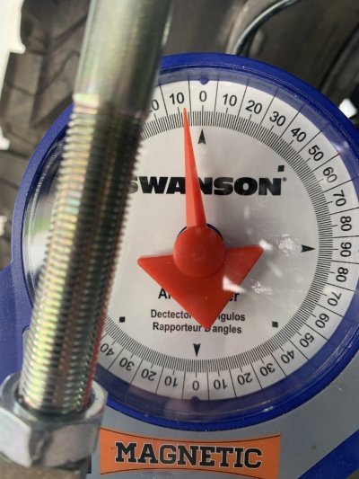

I adjusted the new sway bar links to be 13 1/4 so 1" longer than before, i also touched up the frame hole with a 1/2 drill bit so the upper end of the links will fit clean.
Now the sway bar angle looks more pleasing to my eyes
49928015072_97f9c84b6e_k.jpgUntitled by RAM RSM, on Flickr
With the angle at about 7*
49927714456_f97055d2a0_k.jpgUntitled by RAM RSM, on Flickr
So cheating on the driveway now she reads 0* lol
49927727986_8336a64daf_k.jpgUntitled by RAM RSM, on Flickr

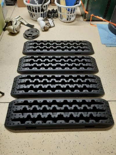

To pass the time i ordered a couple of Amazon led pods to use in my rear bumper and 4 recovery pads to throw in the truck bed to have more recovery gear. Alsol I've been keeping an eye on the Barricade bumper with the winch mount https://www.americantrucks.com/barr...with-led-lighting-r109761.html#product_pics-3
