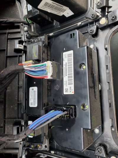

Hi,
I'm new to the forum and have looked around some for recommendations and instructions for upgrading my 2014 2500 Big Horn from the Uconnect 5.0 to Uconnect 8.4. It seems there are a couple different ways but it all depends on current options/features and desired options/features of the new system. Any information is appreciated and I can definitely tell there are some people in this community that are experts at these upgrades. I will list my current OEM features below and what I'm looking to do with the 8.4 upgrade. I also attached some pictures of the bezel and radio wiring.
Current 5.0/Truck Features:
- Uconnect 5.0 with hands free calling/Bluetooth media, satellite radio, FM/AM, usb/audio jack in center console (center console is the one where it is lifted for additional seat, not the one fixed to the floor all the way to dash)
- Auto dimming rearview mirror with Bluetooth setup (side mirrors also auto dim)
- Steering wheel controls for both radio/Bluetooth and phone controls
- Heated steering wheel/seats
- upgraded gauge cluster
- 4 speed blower/fan control (manual)
Desired 8.4 upgrade features: (I don't mind staying with the 4 speed fan if there is a significant price difference in that upgrade vs the climate module, etc.. upgrade and new auto temperature bezel)
- Android Auto/Carplay functionality
- maintain all Bluetooth/phone functionality with the integrated steering wheel controls and rearview mirror
- heater controls to work on both the touch screen and manual adjustments (may not be available if sticking with 4 speed control bezel, idk)
- heated seats/steering wheel to work on both touch screen and manual on/off buttons (may not be available if sticking with 4 speed control bezel as well)
- don't really need the navigation since I plan on using the Android auto/Carplay for that but if it comes with preprogrammed with the head unit purchased I would keep it
Thank you guys again and sorry for the lengthy post,
Drew

@Mpgrimm2 can tell you exactly what parts you'll need and sell you all of the harness/adapters you will need to make the upgrade work.
