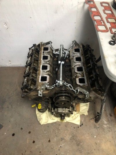

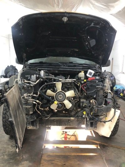

I was just cruising about 25MPH and the engine started making a tapping noise and also running rough a couple of weeks ago. I shut it down and had it towed to the house. This weekend I got a chance to break it down a bit and what I started seeing didn't look good. There was oil on the intercooler under the blower and when I opened up the intercooler there was a puddle of oil in it at the Map sensor. The oil felt gritty and the intake runners looked like they had 300K miles of crud on them. The engine only has 45K on it so there is something seriously up with the PVC system. I have 2 catch cans on it but something is not right.
The engine is ready to pull this coming weekend for a break down to see how bad this is internally.

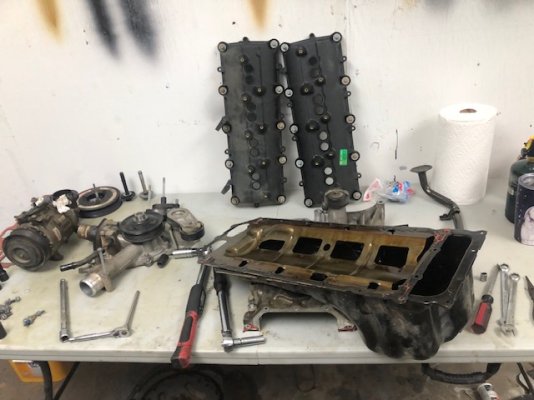

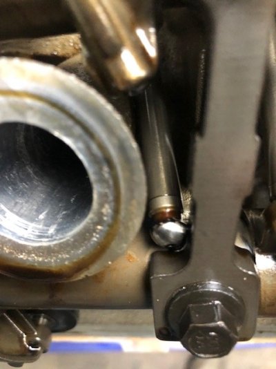

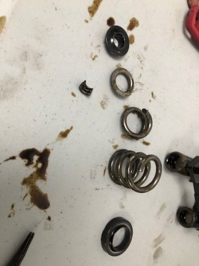

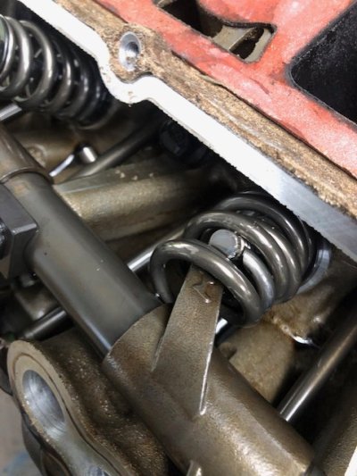

Well Crap!! Looks like spring failure. Probably a good thing it let go at low RPM or it would have been worse. Time to back up and punt again...
Engine Fail 7.jpgEngine Fail 6.jpgEngine Fail 5.jpgEngine Fail 4.jpgEngine Fail 3.jpgEngine f.jpg
