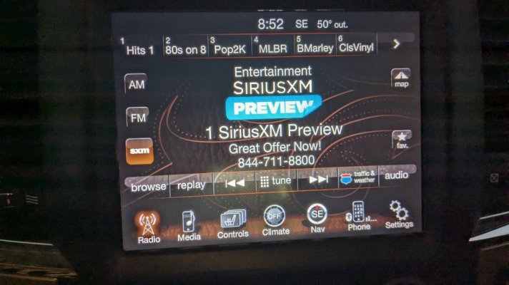

Well, this is all I'm getting with SiriusXM so I'm guessing the antenna? What do you recommend?
Thanks!
Thanks!
You can replace the antenna on the roof. Dou you know which kind you have (sharkfin or puck)?

It looks more like a sharkfin. Is this your recommendation? Have you done one, is it hard?
Yes, I'd try to replace OEM but you might be able to get a cheap GPS antenna on Amazon that will work too. It's not difficult to access, is yours on the rear drivers side?

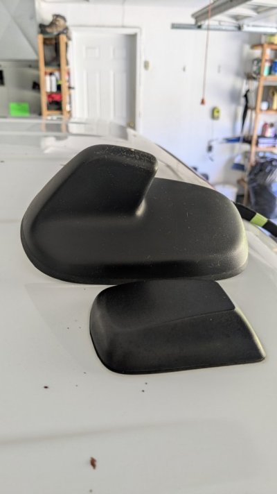

Well damn, I zoned out and ordered the wrong one. It said on the site that it's compatible with my truck, other than being bigger do you think it'll work?
Thanks.
Thanks.
Probably. The Sharkfin just has an additional antenna connection you don't have the wiring for, but the GPS/SXM connection should be there.
