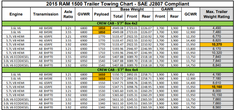

I agree that it is more than what it SHOULD pull, I was really only wondering if it COULD pull it..since I'd only be making a few short trips with it. I have the build sheet that came with the truck, VIN matches. I ran it online and found this chart which matches up to said build sheet. It's the crew cab 4x4 with the 5'7'' bed. You can see why one could assume that it was bought with the intentions of towing.
According to the build sheet it lists these options (including but not limited to):
Front Heavy Duty Shock Absorbers
Front and Rear stabilizer bar
Trailer Tow Group
8Spd 8HP70 Transmission
Anti-Spin Rear Differential
3.92 Axle Ratio
Power Black Trailer Tow Mirrors
Heavy Duty Transmission Oil Cooler
Heavy Duty Engine Cooling
Next Generation Engine Controller
Rear Extra HD Shock Absorbers
Trailer Brake Control
Raised Ride Height
