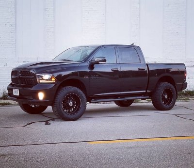

shadowhawk
Oct 30, 2017
3,640
2,839
Southeast WI
hemi 5.7 with I2 tune
my falken wildpeaks are 75 each, plus wheels. I'm over 120# a corner. Running 3.21 and 35x12.5 rubber. It's still peppy, but not barn burner fast off the line. white wall wheels done.jpg
