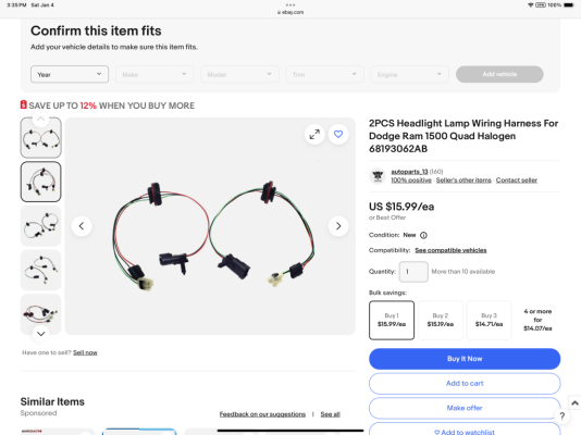

I’ve purchased salvage truck that was hit from front driver side with crushed main harness, also strange is that it comes with dual headlights not quad. My mechanic found a sticker on main harness so I ordered newer version of the same one, so far I remember he had issues with the main pink connector on both sides to connect 9008 bulb for hi and low beams on dual headlights.
Few days ago I was replacing all front bulbs to axito led’s, and I’ve notice that something is wrong on both sides because 9008 bulb is not fitting to the socket and my mechanic used channellock to squeeze that both sides connectors
Didn’t do a picture but got this hi/low beams connector on both sides. Please check attached pic and tell me if I missing something

For the Dual and Quad headlights on the Gen4 trucks are the same connectors on the truck side. Only difference is the Quad trucks are programmed to keep the low beams on with the High beams.
Quad headlights have an internal wiring harness that splits to the Low and High beam bulbs: H11 for the lows and 9005 for the highs.
2012 should have been the last year for the Dual headlights with the exception of the HD and commercial fleet trucks.

I’m not sure but I think that will fit to that pink connector. Will check that out soon and do some pictures after taking out headlights

I’ve only got turn signal connector with pink strait connector without any curve on upper side.
Everything was messed up before purchase including my mechanic that was installing dual headlights on that truck and pushed 9008 socket to that pink connector using channellock…
So now I have no clue if he disconnect some harness from that pink connector
Now I did the same thing trying to push that connector but without channellock and now low beams only works when engine is not running, after I turn on engine my low beams blinking 4 times and getting error… need to check out that connector, but tomorrow
