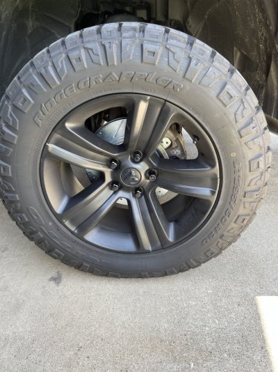

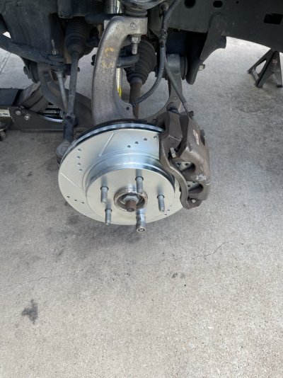

Last month I put the Powerstop Extreme Z36 package on all four wheels which replaced the original OEM’s @ 141k miles. I went with larger tires and the 2” Mopar lift so wanted an upgrade. All good so far. Don’t mind my dirtyass calipers. It’s hot as hell here in Texas. Lol
