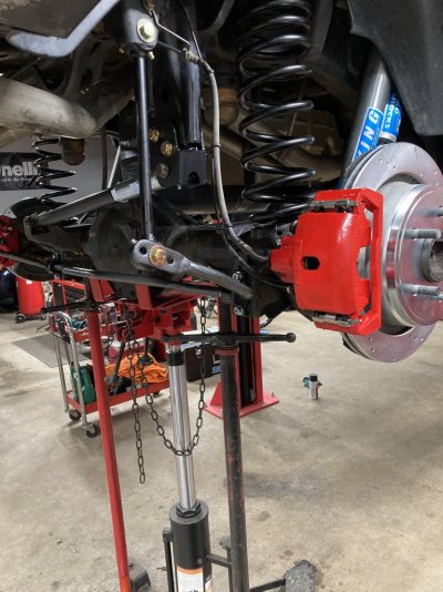

Not long ago I had Power stop z36 installed at Quick-Shifter’s shop, I went with the complete set, been very happy with them. The pads are ceramic & so far there is very little brake dust & a big improvement in braking
