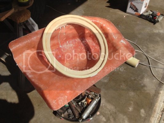

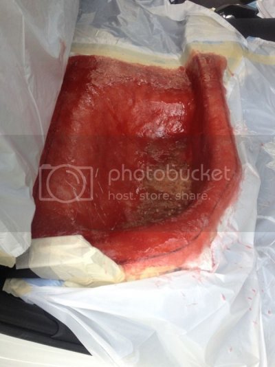

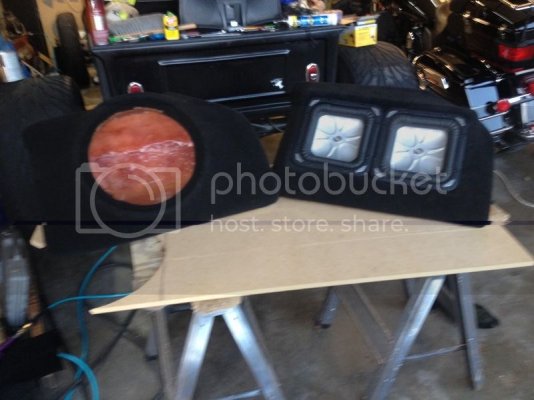

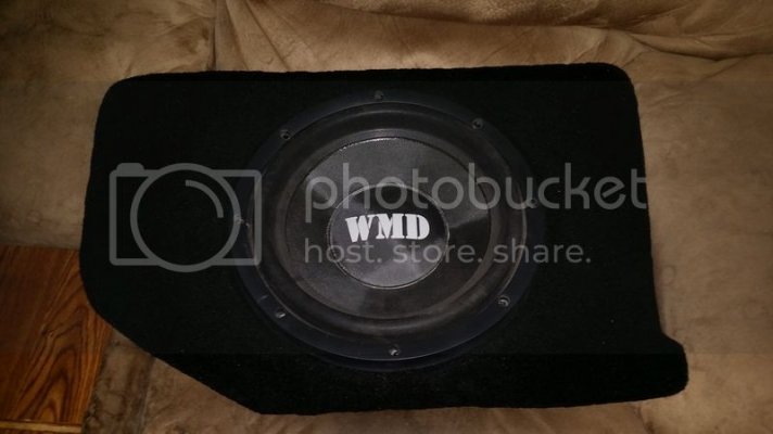

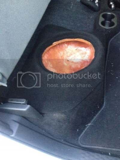

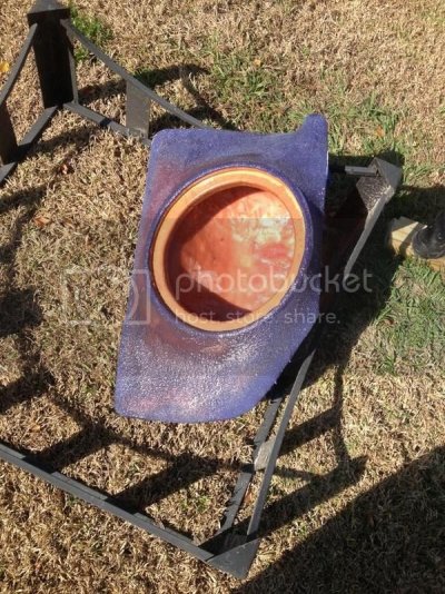

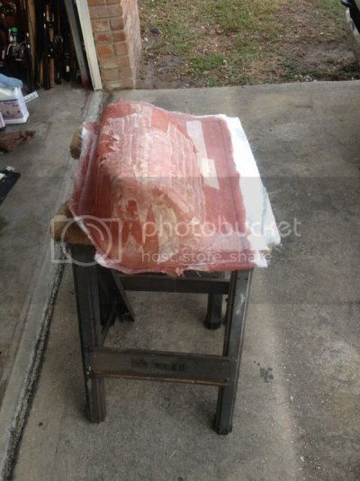

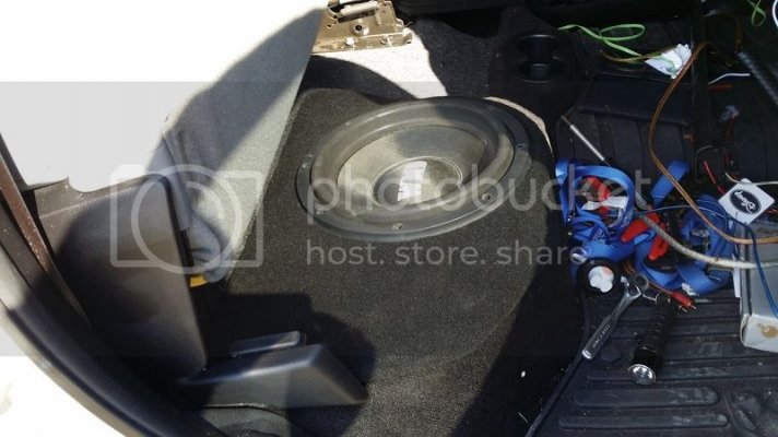

All wrapped up and ready for resin.
Oohhhh an it she pretty? Now need some carpet.

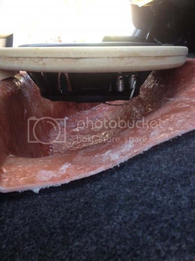

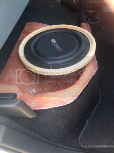

Well folks. It's done. Now time to move on to the door panels.

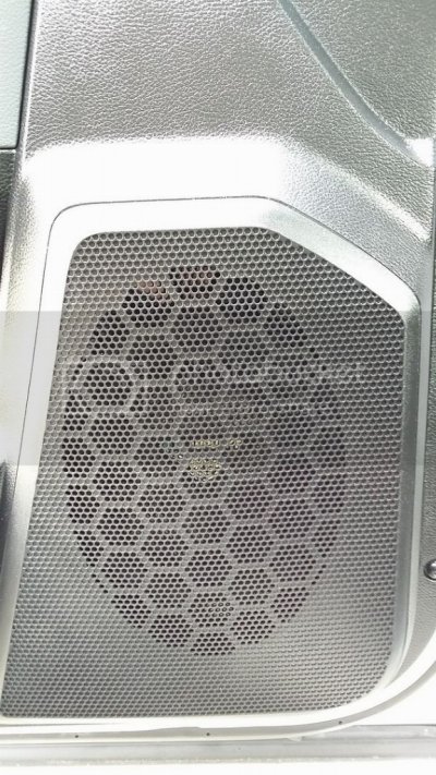

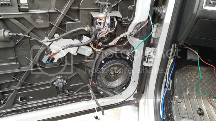

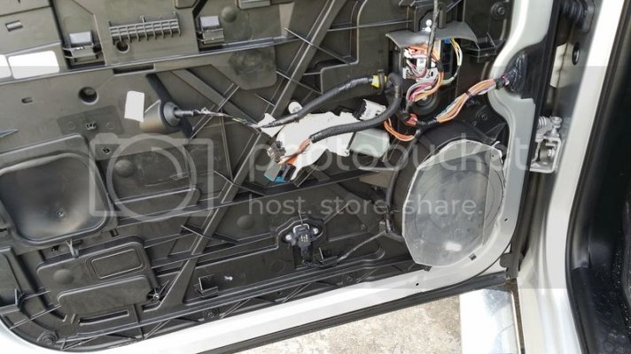

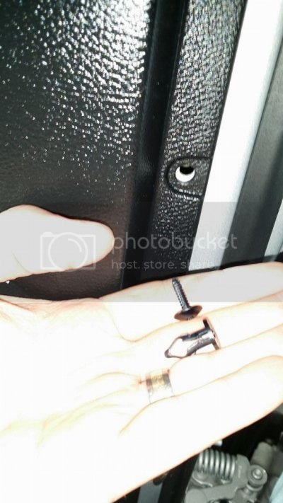

Thanks for all the positive comments. Now on to the more unexciting part of the build, The doors. I did pull the door panel off and I must say it's one of the easiest door panels I have ever pulled. Just a few screw clips and one screw behind the door Handel. Anyone afraid to upgrade their speakers due to fear of removing the door. Dont be super easy so far.
That is going to look nice!!!
troutspinner
Sep 9, 2014
1,256
435
Gilbertsville, Pa
2019 Big Horn Crew Cab
Looking good! The doors are pretty easy to get the panels off. The wiring through the boots takes a little patience if you are rewiring but easy enough. Where are you mounting your tweets?

yea been staring at those boots and trying to convince myself not to run the wires through them. I can see them being a pain in the :roflsquared:
as for the tweeters they are going in the dash and if I don't like them there ill try the sail panel. but with my time alignment I should be able to get them to sound good in the dash so well see.

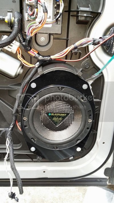

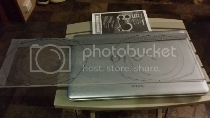

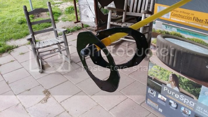

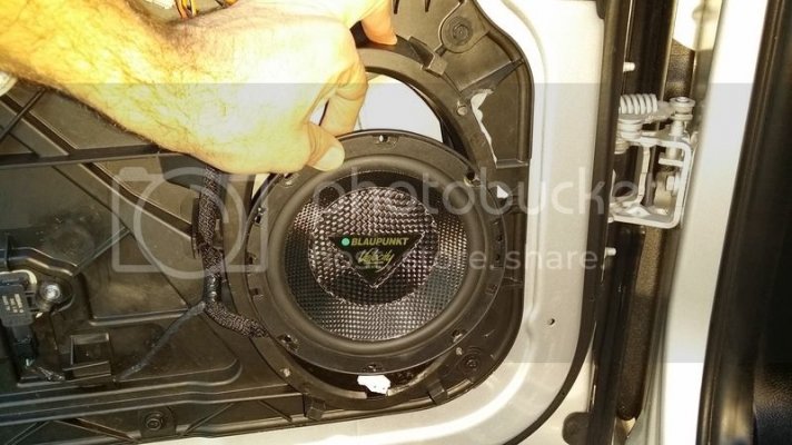

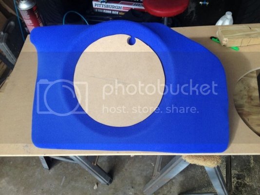

I started making the adapters during the week after work. These poor little ulgy scraps will become beautiful. Lol
I absolutely love the invention of the rotozip.
draft6969
draft6969
Feb 16, 2016
80
31
Pecaniere Louisiana
ecodiesel

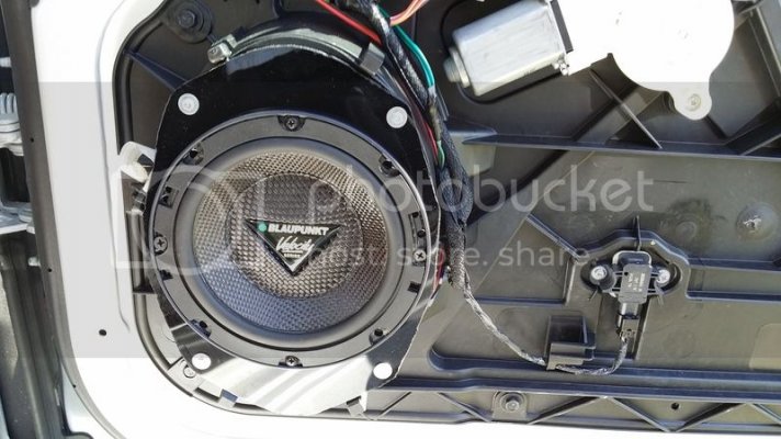

A little test fitting before I get started on them.
Got everything cut and drilled. I painted the back side of the plexiglass so when mounted it will just look like black glossy plexiglass. Looks really nice.

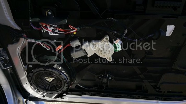

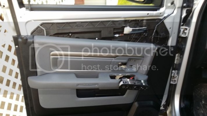

Got the first door buttoned up. It's a shame we put in time and effort to make things look nice and the components themselves are beautiful, all to never be seen again. Lol

Any sound deadening? I was able to get two 16 gauge wires through my front doors with an old wire coat hanger pretty easy not sure about the rear doors I don't have any lol.
draft6969
draft6969
Feb 16, 2016
80
31
Pecaniere Louisiana
ecodiesel
I was going to put some sound deadening but its so quiet already I didn't feel the need to. but I can always change my mind and add some if needed. and thanks for letting me know its not to hard to pass the wires through the boot with a hanger. that was my plan I just figured it would be difficult as most are.

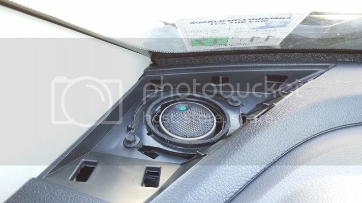

Trying to decide on how to mount the tweeters then decided that when chrystler gives you lemons, make lemonade. Lol. That old junk 3.5" speaker made a perfect tweeter pod.
adrianp89
Sep 3, 2015
3,179
1,277
Tampa Bay, FL
Funny you did that, my lead installer taught me that trick. I am personally not a fan of it if the speakers are good, but if the speakers are blown I am all for it. They make perfect pods!
