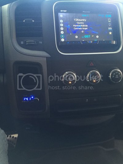

Here's a pic

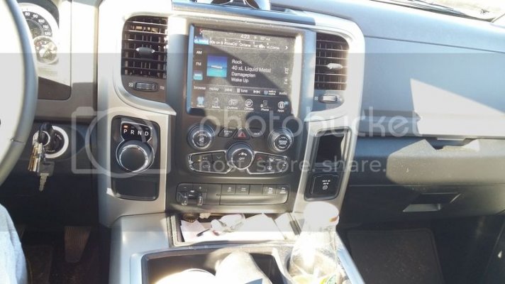

besides where to buy the sail and grills, i have got another question for all you RAM guys here. Where are yall installing the bass knobs at? I have the audio control and I need to access it for the accubass and time alignment. its too big to fit in the little holes in the dash which as far as I can see are good for nothing. lol I've dug through all the ram build threads and found nothing. is everyone just not using them?

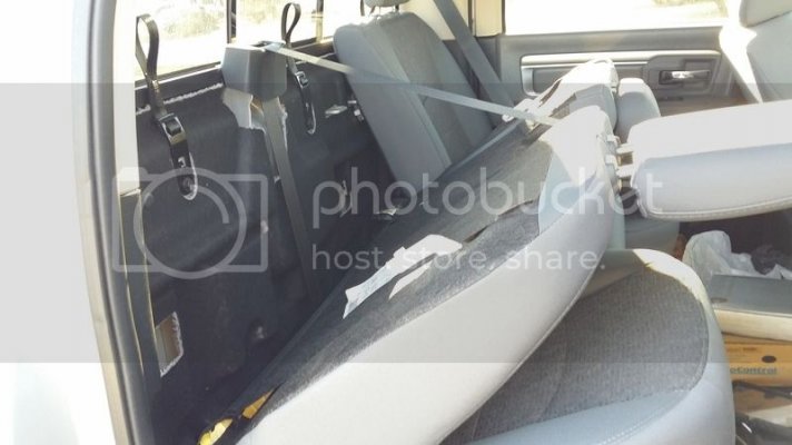

Well i have offically hit my first snag in my project. While test fitting my amps to see how I wanted to lay them out. I found that they don't fit anywhere!!! Well they fit great but the seat won't fold down without hitting them. I'm so discouraged right now cause while I can just get some other amps. I absolutely lover Lunar amplifiers. A brief introduction to anyone not fimilar with lunar amplifiers. Kenny has been building lunar amplifiers right here in good old lousisana since the early 1990's. He was one of the original Rockford engineers back in the 80's and branched out on his own. Anyway these amps are pretty rare and some of the best sounding amps around due to him being very **** about his products. Lol. Fast forward to today lunar doesn't exist anymore and I have been saving these amps for this very build and now they DONT FIT:flame: Ok sorry for the rant. I took some pics and if anyone has any ideas I'm listening. The only idea I have is the seat lift trick to fold the rear seat down. Maybe the 3/4" might be enough?

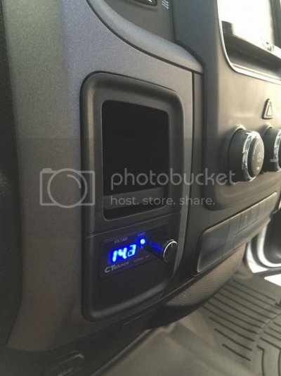

NO way!!! LOL my buddy just texed me that pic and said this looks nice. LOL how funny. but only one problem my shifter knob is right there. lol,
but that is really slick looking. good job
VegasDragger45
May 24, 2010
2,080
1,027
6.7

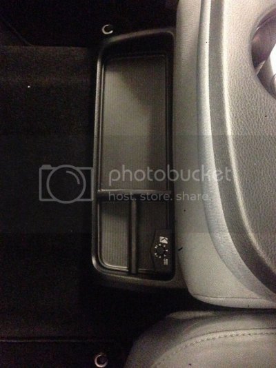

Ha that's funny, Do you have the full console or jump seat? This is where I had my old Kicker remote

It wont fit in the blank under the shift know?

Well i lifted the seat 3/4" and amps still don't fit under the seat but they do fit on the back wall and I now have the ability to fold down the rear seat. So now I'll start deciding on the layout.

I have the console
I mounted my bass knob on the under side of the dash in that pocket at the front edge of the center console. Right about where you see the bottle cap in your picture. I thought I had a pic but can't find it now. Can take one tomorrow.
