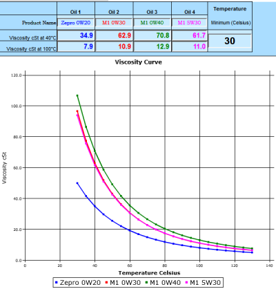

I noticed in that Dr. guys article above, he specified "under certain operating conditions". I wonder if perhaps the viscocity @ 212 isn't the temp where the lash issue may occur, but under some other condition.
Since the 6.4 uses 0w40, but it "must" be ms-12633 certified, and the one feature of ms-12633 that effects the Cam/lifters seams to be it's "low temperature pumpability",
i was looking up the spec sheets of the oils mentioned, just to see under what specific condition does 0w40 more closely match 5w20, and deviate most from 5w30.
The below spec sheets are from Schaeffer Oil.
So, here is 0w40 ms-12633. The Cold Crank Viscosity is 4347:
I'll compare that 0w40 ms-12633 that the 6.4 Hemi uses to spec sheets from the common 5.7 oils, 5w20 and 5w30.
Here is Shaefer's 5w20 spec sheet. The Cold Cranking Viscosity is 4582. The number is a little higher than the 0w40 ms-12633. Anyone know if higher means thicker or thinner? Either way, it's so close that it probably doesn't matter:
Now comparing the 0w40 ms-12633 to 5w30 for the same Cold Cranking Viscosity. So, if 5w30 has a Cold Cranking Viscosity of 5104, it seems to more significantly diverge from the 0w40 ms12622's CCV of 4347. So, does 5104 mean that 5w30s CCV is significantly thicker than the 0w40 and 5w20? If so, does that mean that it would effect the lifters lash more at low temps, and maybe flow more slowly down to the needle bearings? At low temps, until it warms up.
Since the 5w30 has a higher cold cranking viscosity number than the other two, i'm assuming that higher is thicker. Still not sure though.
Or, maybe I'm reading that backwards and it means the opposite. Or nothing at all. :33:

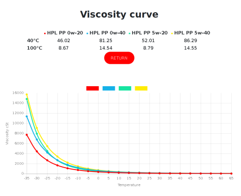

So this is interesting, I used HPL Premium Plus at 4 different grades and plotted the results, I wanted the same formula on all 4 oils to make it as apples to apples as possible and I have the PDS for that oil already so it was quick/easy to do.
Anyway, this graph goes out to -35C whereas yours stops at 30C, and there is an important detail in my graph that doesn't appear in yours, a little crossover of 0w-40 and 5w-20? Right around -20C the viscosity becomes lower on the 0w-40 as you get colder and colder past that point.
I wonder if this is just a thing due to curve fitting on two points and this not being 100% accurate, or maybe it's just a fluke of this formula... or if this detail holds true for more oils as well? Any chance you could rerun your oils but down to -35C instead?
I don't want to cramp this guys thread anymore, but like you see 0w20 and 0w40 doesn't have the same cold properties anyhow, case is closed. We can do more in syn thread, interesting disc.
