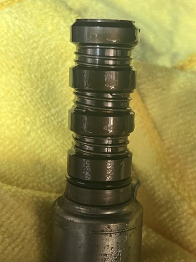

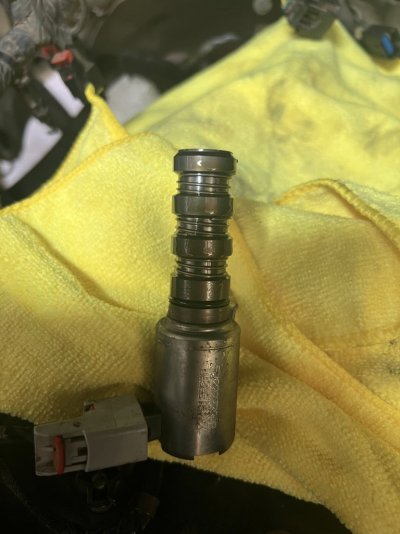

Thanks man, I’ll check out that solenoid. Hopefully it’s clean. I really think I caught this issue early as it didn’t tap very long before I pulled it apart.

So in an effort to not read back through the post did I mention that the lifter that failed is a non MDS lifter? Any thoughts on that? I say that because everyone is very quick to say the MDS is the issue and it seems like most opt to delete the MDS system.
I will be taking front timing cover off tomorrow and I will upload some pictures, hopefully have enough time to get the cam all the way out as well.

Post some pic's of the VVT solenoid,as before you get carried away ordering parts,you better get it out,and check the screens over on it.If it's full of filings,there's no point in stuffing a cam into that block,unless you rebuild it.

I will pull that first thing tomorrow. My oil or oil filter hasn’t had any of that beautiful glint so fingers crossed, I’ve seen some pretty bad cams posted on here (multiple lobes wiped clean) and rebuilds that were successful so I’m honestly not to worried as I have only one bad lifter. The truck was running just fine when I pulled it apart, not even a misfire. If it’s bad with metal I’m not worried about pulling the whole engine and checking crank and replacing as nesscary or heck at that point reman or even new engines are only $4k - $5k still cheaper than a new truck. I already ordered everything as mentioned in previous post. WORST case scenario it would be worth a new engine, my truck is seriously immaculate and I’ve already upgraded a lot as far at suspension goes. It’s a fully trimmed out Laramie, technically a long horn just minus the air suspension which is a good thing in my book. I put bluetooth enabled bags and compressor on it when I bought it knowing I would be hauling 3 tons of pig feed on my trailer at a time.
