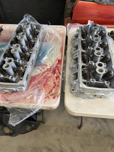

I got a call from the machine shop. I can pick up the heads tomorrow at 9am morning! I will be sure to post pictures of reassembly! I’m so excited to finally get my truck back together.

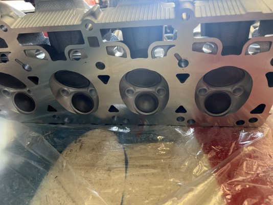

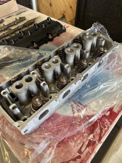

I’ll post pics of how the cylinder heads came out after the machine shop.

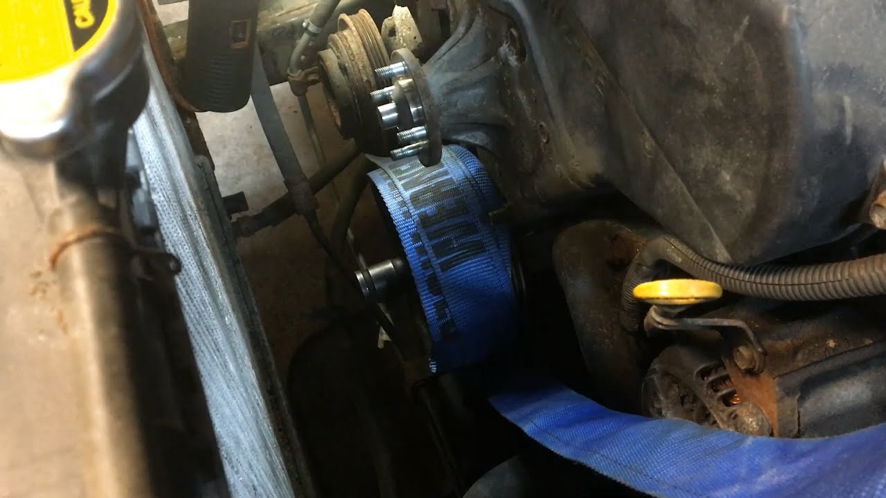

How did ya’ll torque your crank bolt to spec? Or did you just air gun it on and call it a day?
Cylinder heads are on,(ARP head bolts torqued to 100’ lbs is no joke)
water pump is on. Cylinder heads are buttoned up and I turned over the motor with the crank bolt no binding and all valve springs compressing evenly exhaust manifolds are hooked up to the cats.
If there's an Oreilly's nearby:
Or, if you don't want to spend 50$ for a one time use tool:
Got a cargo strap laying around?
Or, if you don't mind a 50% probability of splitting a knuckle and getting a black eye:
One of these around the balancer.
That orange enamel is pretty sweet! I already have a a couple busted knuckles the casting on these cylinder heads is pretty sharp in places lol.
In all seriousness thanks for the advice. I’ll look at that O’Reilly thing not sure it would work on my balancer.
I had tried a a big filter remover with a rubber belt and plastic handle to remove the bolt originally, even with a cheater bar and a helping hand couldn't get off until I used the air gun. The one wild one posted looks nice though. Of course though when I clicked the link Amazon said it can’t be shipped to my current location, probably some California bull crap law.

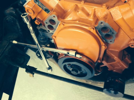

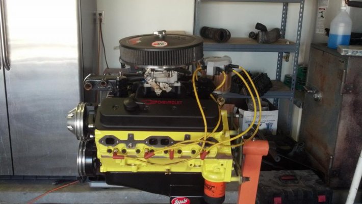

I built this 383 stroker for my boat back in May of 2013.
It's still in the boat, still runs strong, and still running the same OEM Chevy roller lifters that already had 150,000 miles on them when the engine block came out of the IROC Z Camaro Donor car to be built, and installed in the 2000 Chaparral 200SSE.
Ooooohh that’s sexy! The only thing that makes it look like a $2 H-o-o-k-e-r is that fram oil filter ;)
