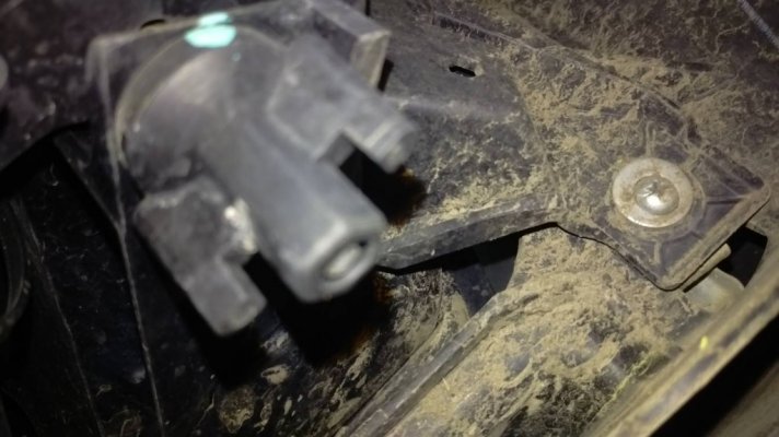

Here is the location that was missing the bolt on the fog light bracket. As mentioned, I used a toggle bolt to tighten it down. The image is the lower right hand bolt hole on the passenger fog light...

Thanks for remembering to post the pic. I'll have to look at mine tomorrow to compare.

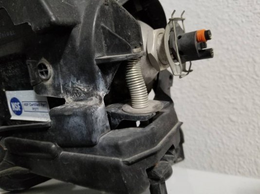

I put a spring between the bottom of the housing the wing nut (through the long bolt that adjusts the up and down) When I had my projector fog lights in they would vibrate/shake like crazy.
When I get home I will snap a picture of my setup.
As someone mentioned above where the fog lights bolt onto the truck in not rigid and a little shake is almost something you have to deal with. Believe me, I tried everything to secure them to the truck.

1st picture is a heavy duty spring tighten down.
2nd picture I used two springs. 3rd is the same.378e39ece6989b346576e1e2ad1adad5.jpgf7a9cfe848f3cedd2162e98eaa70d628.jpg6832a47c20e5829e23c636dd20ba50e2.jpg
