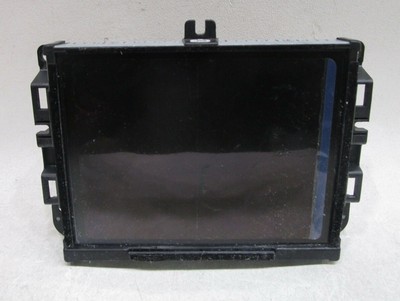

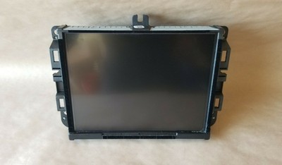

Verify it by radio PN. Last 2 letters don't matter. Make sure screen is intact, and the plastic colored antenna clips on back haven't been pulled off. If from a ram... Get the vin is possible for future SW updates.
Reference: for SW & PNs.
(No, you can't roll back SW)
- INFO- 2013-2018 8.4 FW Notes (RA4/VP4 & UAx NA)
2013-17 ram, Cherokee, & viper used the exact same PN radios.
2016 RA4 VP4-NA NAV
68258671AA, AB, AK, etc
RA4 VP4-NA NAV
68270661AA, AB, AK, etc
Here's a 17 RA4 VP4-NA
2016 RA4/VP4-NA
