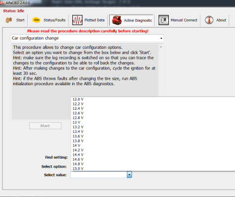

Replaced my low beam halogens with some Sealight LED's. They work for a while then blink a couple of times then go out. The dash then says that I have a headlight out. I have changed the settings using AlfaODB for LED Low Beam Lamps Present to yes. This change did not have any affect. Is there anything else that needs to be changed?
Sealight sent me a "decoder" which I suppose really means resistor. I am hesitant to use these because of the heat that would be generated and afraid of it melting something since it would be inside the headlight housing.
Edit: I finally found a youtube video on a 2016 model that said setting HID headlights to yes in AlfaODB is needed. Once I set this everything works now. No idea why this would be needed since bulbs I have are LED.
Options to set:
CBC Features: LED Low Beam Lamps Present - set to yes
VehConfig 3: High Intensity Discharge Headlamps - set to yes
Not sure if it made any difference but I went ahead and changed the voltages too. On my 2015 it was set to 13.0 V.
CBC Extern.Light.Calibr.: Right Low Beam Voltage Regulation - set to 12.0V
CBC Extern.Light.Calibr.: Left Low Beam Voltage Regulation - set to 12.0V

What did the TSB say the voltage should be raised to? I will check my body computer log to see where mine is set (that setting is in BCM and can be changed with AlfaOBD). The BCM also has the changes for Halogen, HID and LED.

Here is a snippet of the BCM concerning voltages. They are adjustable:
CBC Extern.Light Calibr.:
Auto Headlamp On Threshold (0‐5 V): 3.314 V
Auto Headlamp Off Threshold (0‐5 V): 2.549 V
Left Side DRL Voltage Target: 7.4 V
Right Side DRL Voltage Target: 7.4 V
Left Low Beam Voltage Regulation: 14 V
Left High Beam Voltage Regulation: 14.2 V
Right Low Beam Voltage Regulation: 14 V
Right High Beam Voltage Regulation: 14.2 V
Left Front Corner Voltage: 13 V
Right Front Corner Voltage: 13 V
Left Rear Corner Voltage: 13 V
Right Rear Corner Voltage: 13 V
This is for one of the high beams
