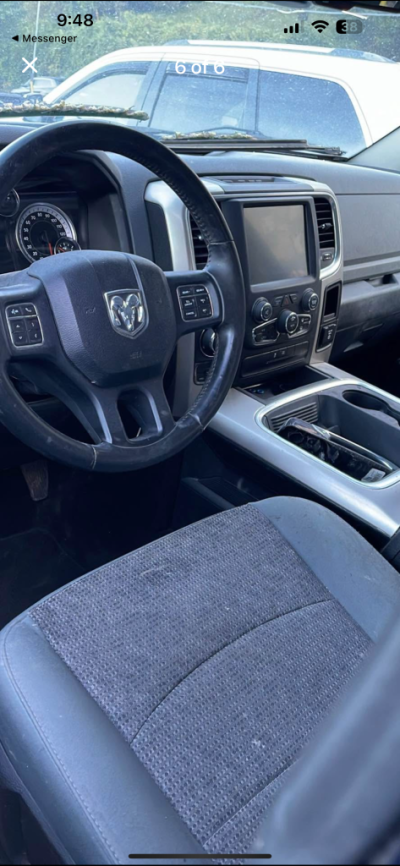

So radio question again . Tired of the android radio . On top I have posted a picture of the radio that was in my truck. With what A/C controls it has . I have found a 2017 ram 1500 SLT with original radio attached is a picture of the one for sale . Entire radio and bezel from dash. I don’t want him to yank the radio just to read the back . Did all the radios come with CarPlay . Or do I have to ask what the code is . If so I have what was written above about what radios I can get . So my question is I was told 2015-2019 is ok . Lease someone point me in the right direction . I know enough to be dangerous . Rather listen to people with experience then thro money away. This is the system I am looking at . Thanks IMG_0377.png

Thank you for the reply , guess I am still looking then.

If you need or want that android auto/car play then you will want to stay with the 2018 + but if you are ok without that you can get 2017 or under. down to 2013 but not recommended to go under 2015. I personally don't need android auto, and while it would be nice, I think some other benefits of the new radio are there I just want the bigger screen and the things that brings so I am going with the 2016. less things needed to make it work, and if I want in the future I can update just by getting the radio and one or 2 things needed.
Benefit of AA/CP integration is hands free phone use (expanded) and up to date navigation.
