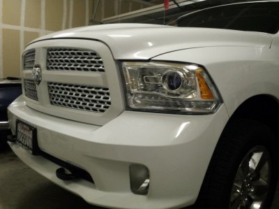

What does your bumper look like? Before you start cutting the plastic!

This is what I have

That's exactly like mine. I ended up switching the hooks to opposite sides when I installed them. When you get the plastic piece out sick the hooks up into the mounting holes and you will see what I mean. They come very close to the bumper. If you switch sides they fit much better.
