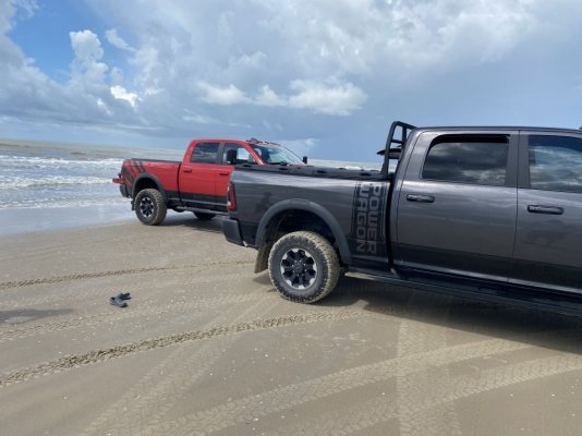

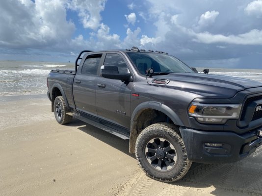

Gray one is on AT 35s with no lift. And the red one is on MT 37s with a 1.5 wheel spacer. Light trimming
