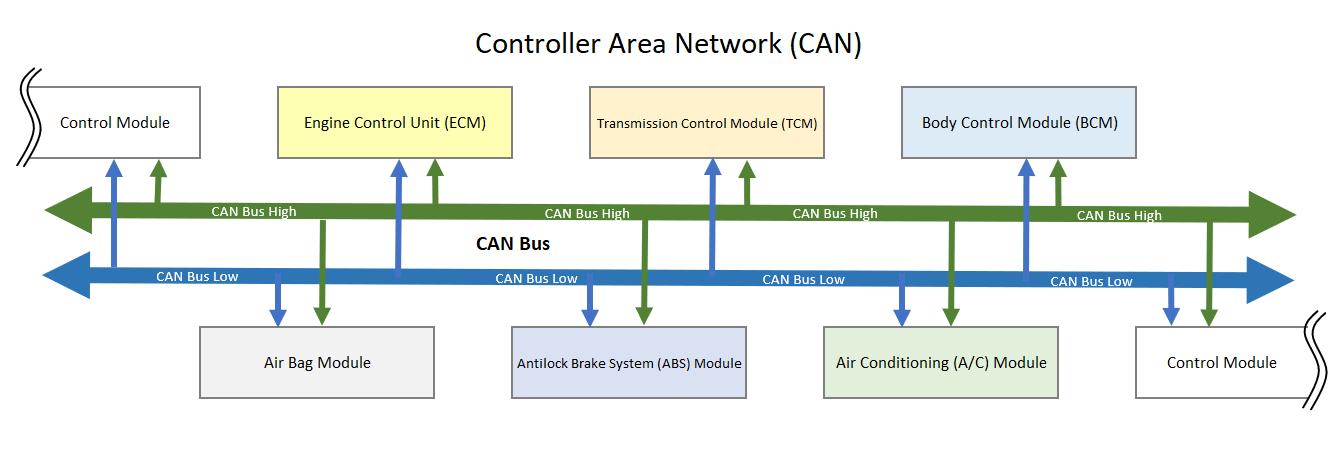

Looks like your Transmission is not communicating with your PCM
possibly rodents chewed on the wires

Right! And that’s where I’m at digging into this. I just can’t figure out why it’s not. I have check all the wiring and what not, doesn’t seem to be an issue. With that being said, I think it is one of the modules mentioned in the thread, just trying to figure out which one.
And if my truck even has a TCM, If so where? And where can I find the part?

on 3rd Gen Rams, the TCM is between the air filter & the firewall
the video that i saw showed the guy fighting some wires
Maybe he did not know that the whole air filter box lifts out, just needs a good jerk
This video shows how to trouble shoot U0001, on a Chrysler
