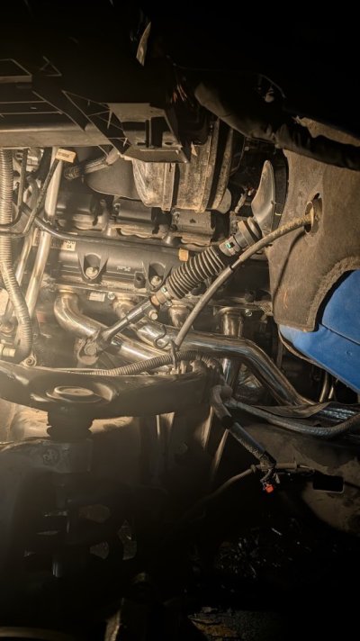

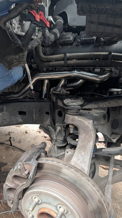

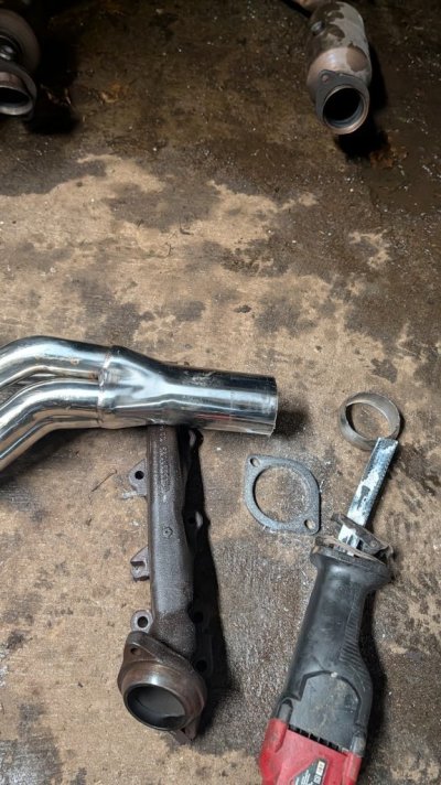

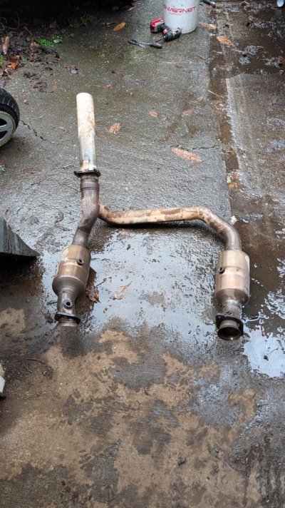

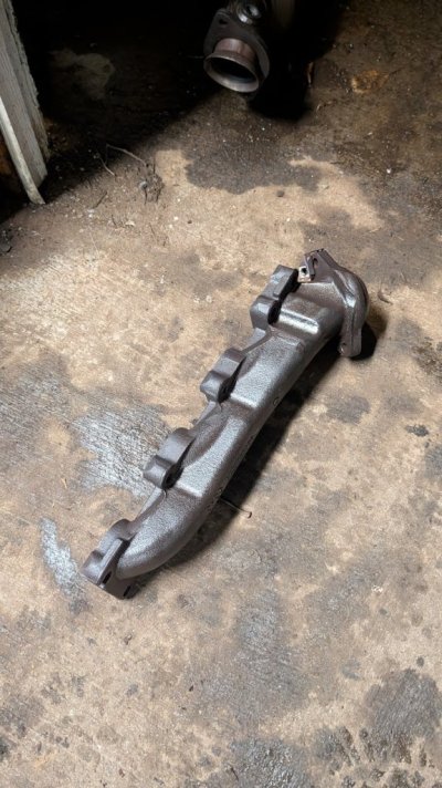

well is started installing the headers not the hardest but not the easiest.
i cut off the flanges and doing it ls1 style with band clamps. i need to fab a y pipe
shouldn't be hard i think its going to turn out nice
i did the drivers side first gunna try to finish it tomorrow

Make sure you check the clearance around the fuel and brake lines on the drivers side frame rail,you can move them up,if the headers are a bit close to them. I'd of wrapped the headers,as i'd rather replace a set of headers every 10 years,then fix heat cooked wiring/hoses every 5 years,but that's only my opinion and experiences. Even coated they still radiate alot of heat

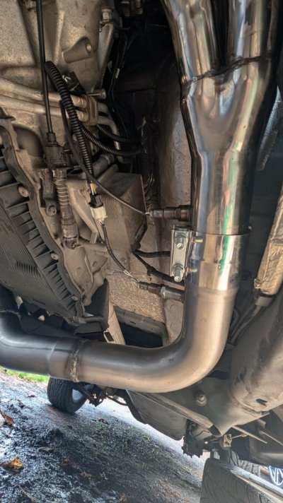

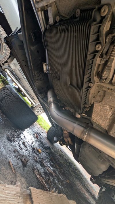

got the passenger side header on, and got the o2 extensions on.
whoever thought it was a good idea to put the o2 sensor plugs on top of the transmission with little to no slack in the wiring should be kicked in the nutz
the oil dipstick was kinda a pita to put back in
going pretty smoothly though none of the bolts were even remotely like they were stuck in the head, the gaskets looked new so maybe it leaked before

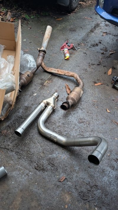

i fabbed up a y pipe, its tac welded. i'm going to weld it together tonight need to take a break

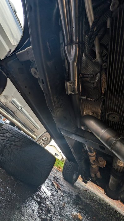

Well it looks good and is ready to start

Wel it's done sounds nasty
Had to put some heat wrap around the shifter cable

I insulated the heater hoses on the passenger side.
Also another reminder on the brake and fuel lines , on drivers frame.

You didn't have to clearance the primary close to the steering shaft? They look pretty good being Ebay. I was thinking of doing those too. My fab skills for the y pipe aren't as good as yours ...

I didn't even notice until I was putting the driver's side inner fender on how close the steering shaft was, it clears the header runner by millimeters but it seems fine.
I also installed that header without disconnecting the shaft

Go make a sharp right hand corner while accelerating slightly,if the headers are going to hit the steering shaft,that's the way to tell
