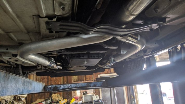

I don't care about the sound from the headers I care about the clapping, the muffler stopped it from coming out of the exhaust but I can hear the clapping sound through the cheap y pipe
That's where we are at, I'm not going to take the ******* headers off and wrap them
B
bonnyjliss
Aug 16, 2019
232
157
oregon
This y pipe never heard any clapping out of it, had it out of the exhaust at a certain rpm without a muffler
With a muffler, no clapping sound.
The y pipe makes a smooth transition than this **** thin amazon one.

14 Sport
If you're gonna post a picture,at least make it a truck picture :rolleyes:
