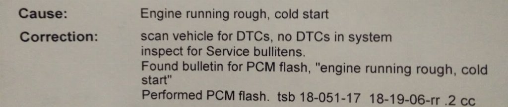

As a followup, the dealer did a PCM flash from a TSB 18-051-17
Seems to have fixed the idle at start, by what appears to me as just making the idle sit higher for about 5 seconds
