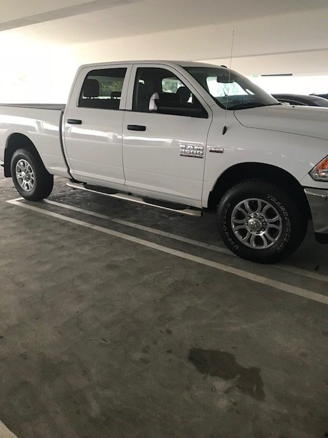

Yes, the new wheels are brand new take offs from a 2016 RAM 2500 Laramie (Same year/model as mine, just higher trim package). They had about ~3k miles on them. thanks
here is my truck with the new wheels
That doesn’t mean they’re still in there. He probably pulled them for his new set of rims and tires.
sigh, i think you are right. Discount tire said they will take the ones off my old wheels and reinstall for 76 bucks. bummer
cliffslocal
cliffslocal
Dec 1, 2015
17
Just to close the loop on this. There were no sensors in new tires. Doh! Had to pull off the old ones, all good now.
